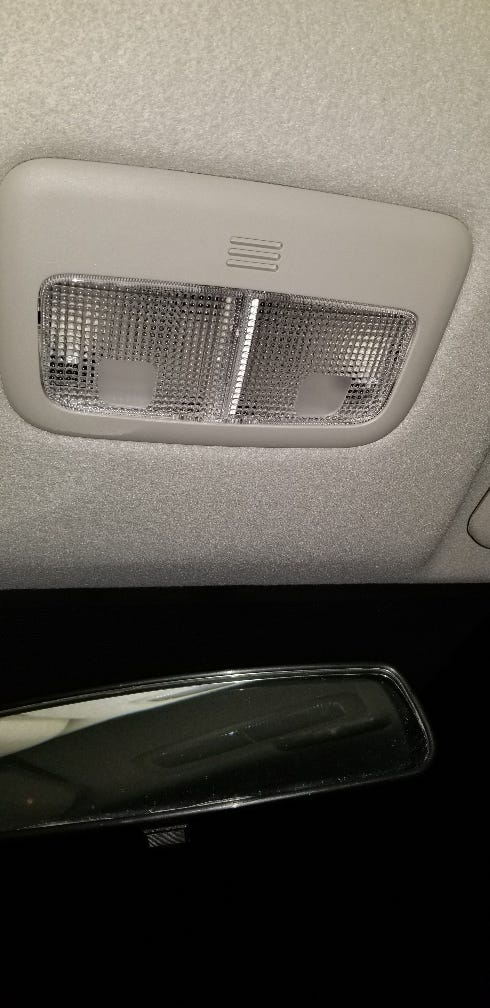

Anyone know how to remove this map light housing? I'm upgrading my radio and want to add an external blue tooth mic. Can't find any instructions on removing it and don't want to break it.

Youll have to take a very small and very thin flat head screwdriver to slowly and very gently pry at about where the 3 little stripes are( middle of the clear plastic area to where it meets the harder outter shell ) . The clear plastic will have a small tab on the right and left sides...and one in the front end.........Once you get the clear plastic cover off youll need to get the bulb out and you should see the phillips screw that needs to be removed and then you can remove the entire housing piece.
