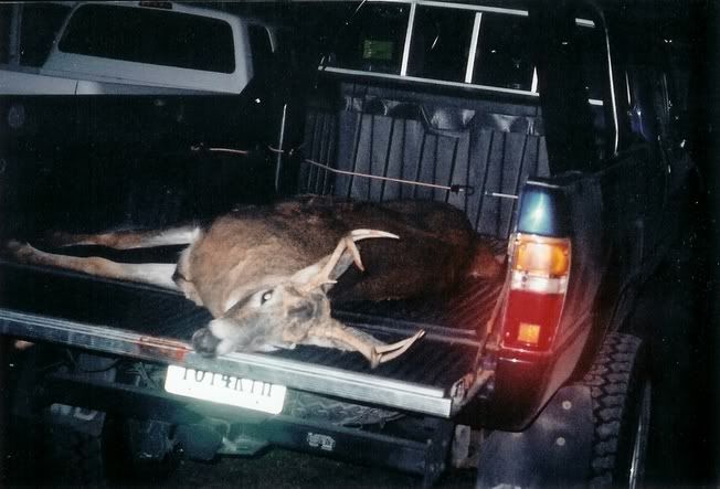

My 1988 Toyota pickup (3.0L v6, 4wd, automatic, regular cab, longbed, w/6" lift) was a great truck. In fact, my truck was just shy of 200,000 miles when someone broadsided me and totaled the truck. With almost 200,000 on the odometer it was still running great and I have no doubt it would have easily made it to 300,000 miles without any major problems. I never had to do any major engine work to it (I had a tune-up done around 120,000 miles flushing all the fluids, and replacing things such as the belts and water pump) and never had any engine problems at all. I drove that truck VERY HARD- and that was with heavy 33" tires and 6" of lift. When I bought the truck it had 75,000 miles on it and the only thing the previous owner had done with the engine was take it to Toyota for the head-gasket recall. People give the 3.0L a bad rap and it does not deserve it, with just basic routine maintenance that engine will last a VERY LONG time.
The 3VZE 3.0L v6 has pretty much the same amount of power as the 3RZFE 2.7L 4 cylinder that was available in Pre-Runner/4wd 1995.5-2004 Toyota Tacomas. It won't win many races, but it also won't leave you stranded on the side of the road either. :thumbup:
Some crappy pics of my 1988 (I have some better pics of it...I just have to find them):
Working hard in hunting camp:
2 tacomas said:
x2
That's so nice of you, taking that sick deer to the animal hospital!
The success of your engine was probably aided greatly by the head gasket at 75k.
